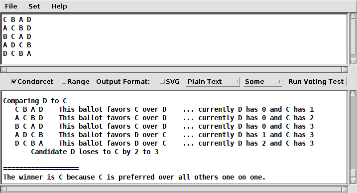

To support this discussion, here's a slightly modified version of my 2010 voting program (part of the voting work I was doing for both USHPA and the HGAA that year). It mostly ran as a stand-alone program, but I've adapted it for this forum. Right now it only implements the "Condorcet" voting method, but I can possibly add other methods as time goes on.
It's pretty simple. The top window is the list of votes (line by line) and the bottom is the results. Each line represents a single "ballot" cast by a single voter. The choices are typically letters, and you just list them in the order that they're preferred on each ballot. The favorite choice is listed first and the least favorite is listed last. Any choices that are considered equal can be separated by an equals sign (=). When you press the "Run Voting Test" button, it compares every candidate to every other candidate in a series of exhaustive "one on one" runoffs. It then tells you (in the bottom window) if there is any candidate that defeats all other candidates. It also gives you a complete description of how each candidate would do in each pairwise "runoff". The program comes up with a default election (series of votes), but you can change the votes any way you like and then press "Run Voting Test" to see the results. This is the kind of tool we can use for experiments and to show each other examples of things that we like or don't like in a voting system. Please give it a try.
For example, if you want to see a "rock paper scissors" kind of tie, try out these ballots:
    rock scissors paper
    paper rock scissors
    scissors paper rock
You can also paste them as just letters (which reduces the amount of horizontal scrolling needed to see the results):
    R S P
    P R S
    S P R
Just copy them and paste them into the top window (be sure to delete any other votes already in the top window) and press the "Run Voting Test" button. You may remember this as a circular example because rock breaks scissors, paper covers rock, and scissors cut paper. It's the classic three-way tie that arises from a group decision even though each member of the group has their own clearly defined preferences.

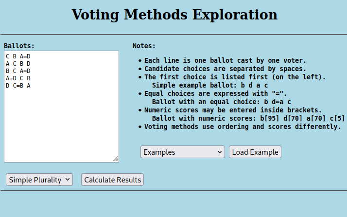

JavaScript Voting Program (Version 021)
As mentioned above, most browsers no longer support Java "out of the box", so I've recently rewritten the voting program in JavaScript. It has a slightly different interface than the previous version, but it should run in all modern web browsers. I will probably install it into our forum at some point so people can use it anywhere that they want to take a vote on something.
Moderator's Note - October 5, 2024: The Javascript version is now available here:
                https://ushawks.org/voting/Voting.html
For now, the program is attached as an HTML file inside a Zip file that you can download, unzip, and run inside your web browser on your own computer. I'll describe it in the next post.
Voting_021.html.zip
(7.56 KiB) Downloaded 364 times
Posts: 8518
Re: Abstract, General, Voting Discussions, Examples, and Too
Postby Bob Kuczewski » Tue Oct 11, 2022 6:11 pm
Introduction to JavaScript Voting Program (Version 021)
I've recently rewritten my 2010 voting program (originally written in Java) as a JavaScript program (see previous post for download). The interface is somewhat similar to the original, but it has been improved in a number of ways. Here's a screen shot of what it looks like when you first open it:
If you don't change anything and click on the "Calculate Results" button, you'll find that those votes select "A" as the winner. That result would be based on the "Simple Plurality" default voting method setting. But if you change the "Simple Plurality" setting to "Condorcet" and click "Calculate Results", you'll find that those same votes will select "C" as the winner. So what's up? How can the same ballots produce different results? That's what this post is all about. Please read on ...

Ballot Area Description
The ballot area is the large text entry box in the upper left corner of the page. The "Notes" section (to the right of the ballot area) describes the expected format of the ballots in the ballot area:
  • Each line is one ballot cast by one voter.
  • Candidate choices are separated by spaces.
  • The first choice is listed first (on the left).
          Simple example ballot: b d a c
  • Equal choices are expressed with "=".
          Ballot with an equal choice: b d=a c
  • Numeric scores may be entered inside brackets.
          Ballot with numeric scores: b[95] d[70] a[70] c[5]
  • Voting methods use ordering and scores differently.
You can type ballots in directly. You can copy and paste ballots from other sources. You can select and load from among the predefined examples.
Examples Selector Description
The Examples selector selects from among the predefined examples. The actual example isn't loaded into the Ballot Area until the "Load Example" button is clicked.
There are a number of examples currently listed, and some of them were intended to replicate the examples coded into the Java version (they typically start with the name "Java"). The example listed as "Examples" is the same one described above with four candidates and five voters. The "Rock Paper Scissors" example shows a case where three candidates should tie (although the Instant Runoff's random elimination will produce a non-tied result).

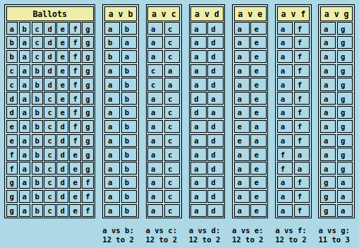

Hidden Consensus Example
The "Hidden Consensus" example demonstrates a strong consensus candidate ("a") running against a number of "factional" candidates ("b", "c", "d", "e", "f", and "g"). Simple Plurality selects a winner of "g" because there are 3 voters (out of 14) who listed candidate "g" as their first choice. So plurality selects a winner of "g" even though 11 out of 14 voters expressed a preference for "a" over "g". In fact, "g" was the last choice for 11 out of 14 voters. Similarly, the Instant Runoff method eliminates the consensus candidate "a" in the first round because the consensus candidate is not strongly endorsed by any of the factions. So Instant Runoff selects a winner of "b" even though 12 of the 14 voters expressed a preference for "a" over "b". Here are the ballots:
a b c d e f g
b a c d e f g
b a c d e f g
c a b d e f g
c a b d e f g
d a b c e f g
d a b c e f g
e a b c d f g
e a b c d f g
f a b c d e g
f a b c d e g
g a b c d e f
g a b c d e f
g a b c d e f
Here are the results from the Condorcet method:
The leftmost table (above) shows the original ballots. The remaining tables ("a v b", "a v c" ... "a v g") show the one-on-one comparisons of candidate "a" with each of the other candidates ("b", "c", "d", "e", "f", "g"). The text below each table shows the vote count by which candidate "a" defeats each of the other candidates:
a vs b:12 to 2
a vs c:12 to 2
a vs d:12 to 2
a vs e:12 to 2
a vs f:12 to 2
a vs g:11 to 3

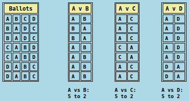

Java Strong 2nd 2 Example
The "Java Strong 2nd 2" example is another case where the Condorcet winner ("A") would easily defeat every other candidate (by 5 votes to 2 votes each) even though the Simple Plurality and Range methods pick other candidates.Here are the ballots:
A[9] B[4] C[3] D[2]
B[9] A[4] D[3] C[2]
B[9] A[4] D[3] C[2]
C[9] A[4] B[3] D[2]
C[9] A[4] B[3] D[2]
D[9] A[4] B[3] C[2]
D[9] A[4] B[3] C[2]
Here are the results from each of the 4 voting methods:
MethodResulting Winner(s)
Simple Pluralitytie between B, C, and D
RangeB
Instant RunoffB
CondorcetA
Note that the Condorcet method is the ONLY one to pick candidate "A" as the winner. Here are the results of running each of the other candidates against the Condorcet winner ("A") in one-on-one elections:

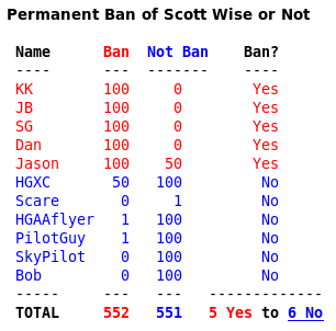

Real World Example - Banning of Scott Wise from HGAA
By the way, here's a real world example from the sport of hang gliding where a bad voting system can allow a minority to rule over the majority.
Back in 2010, a large number of pilots were very interested in forming an alternative to USHPA. I started a topic on hanggliding.org to gather support, and we had lots of people signing up in just a few days. I wanted to have those founding discussions right there on hanggliding.org, but Jack Axaopoulos decided to set up another forum and force everyone to post there. I trusted Jack at that time (a big mistake), and I went along with the plan. It turns out that the "new site" was more of a "back alley" where Jack was able to control and eventually kill the new organization. But that's jumping a little ahead of the story.
When we started the new organization (eventually named the HGAA), there was a consensus selection of Scott Wise to be the Chairman of what we called the "Transition Team" that was going to lay the foundation. But Jack Axaopoulos could not control Scott, and Jack wanted to install another Chairman and then ban Scott from the site. But first Jack needed to establish a voting system that would allow a minority of the Transition Team to defeat the majority (who objected to Scott being banned). That's when Jack began pushing what is known as "Range Voting" (rating candidates on a scale of 0 to 100) on the HGAA. That's when I first began researching voting systems, and I found that Range Voting was highly susceptible to manipulation because there is no way to establish and enforce the meanings of the "points" used in the voting. One voter might feel that very few candidates deserved to be rated at the extremes (near 0 or near 100) while another voter might realize that they can maximize their influence on the election by only voting with the extremes (0 and 100). I pointed this out to Jack Axaopoulos, but he claimed that anyone voting with those extremes (0 and 100) would be obviously seen as "corrupt" and somehow be restrained or punished (although he never explained exactly how that would be determined or implemented). But Jack was the boss (not because he was elected ... but because he ran the site), so he intimidated everyone into using his "Range Voting" system. Guess what happened next.
Yup, you guessed it. An important vote came along and almost all of Jack's cronies voted the extremes (0 and 100) to get their way. And those pilots who swallowed Jack's rhetoric and refrained from voting the full extremes ended up losing. That's how Scott Wise was permanently banned by a minority vote of the Transition Team who were (in Jack's own words) obviously "corrupt". Here's the vote count:
Go ahead and count the number of voters who favored banning (higher score to ban than to not ban). They are shown in red, and there were 5 voters in that group ("KK", "JB", "SG", "Dan", and "Jason"). Then count the number of voters who favored not banning (shown in blue). There were 6 voters in that group ("HGXC", "Scare", "HGAAflyer", "PilotGuy", "SkyPilot", and "Bob"). So 5 favored the ban, and 6 opposed the ban. But the stupid Range Voting system (and Jack's warnings against voting 0 and 100) ended up having Scott permanently banned from the HGAA that Scott himself had helped to found. The point count was 552 to ban and 551 to not ban. Note how many "Not Ban" voters had been intimidated by Jack's warnings to stay away from the extremes (Scare, HGAAflyer, and PilotGuy). Any one of them could have brought about a tie, and any two of them could have reversed the result. Also note that all of Jack's cronies (except Jason) voted the full extremes (100 to ban and 0 not to ban). Jack ("SG") himself voted 100 to ban and 0 to not ban even though he said that such voting would be seen as "corrupt".
Now take those same ballots and put them into the Voting program. Here are the properly formatted ballots to copy and paste:

Try any of these real voting systems:
      Try Simple Plurality: Not Ban
      Try Instant Runoff: Not Ban
      Try Condorcet: Not Ban
Then try Range:
      Range: Ban
Scott was banned from the HGAA through Jack's insistence on the Range Voting system. As you'll notice, I was still a member of the Transition Team at that time, and I was smart enough to vote the extremes. But Jack had begun whittling away (or driving away) good pilots like Scott Wise and Joe Faust. It wasn't long before he had enough clout to take me out as well. And the HGAA disappeared into obscurity soon afterward. The lynching of Scott (and others) will be a permanent stain on the pilots who participated in it.
As for Range Voting? Jack always boasted that Range Voting was used in the Olympics, and that's true. But Olympic judges are NOT the actual competitors and they are expected to show a high degree of impartiality (although that's been an ongoing problem for them as well). The Range Voting system is guaranteed to break down when "push comes to shove" and when the "judges" have highly vested interests in the outcomes. That's exactly what we saw with the HGAA. But there was another element that made it even worse. If the voters had been given proper information (and over time if they have learned it themselves) they would have known that they should ALWAYS vote the extremes (0 and 100 in the HGAA example) to maximize their chances of getting the result they wanted. Jack's team certainly knew that, and that's why 4 out of 5 of his cronies voted exactly 100 and 0. But many of Scott's supporters were too timid to push those extremes (likely due to Jack's accusations of "corruption" for doing what Jack himself did). So only 2 out of Scott's 6 supporters voted the maximum limits (SkyPilot and myself), and that was 1 too few for a tie (which would not have justified banning Scott). If there had been many more future votes (there weren't because the HGAA imploded shortly afterward), then all the team members would have quickly learned to ALWAYS vote the extremes of 0 and 100. But then that would have undermined the whole point of "Range" voting in the first place. That's why Range voting is a stupid system to use when there's a lot on the line or when voters actually care about the outcome. Range Voting is included in my voting program only to show how stupid it is. Thanks Jack.

The Javascript Voting program is now available online here:
The "Hidden Consensus 1" example (found in that program) is a simple example where there is a Condorcet winner, and yet all other methods choose another winner. Here are the regular ballots (without "Range" scores) for that example:

The answer is actually surprisingly easy. Candidate "A" can be proven to be preferred by the voters over EVERY OTHER CANDIDATE. Let's start by seeing how "A" would stack up against the closest competitor "B". Here are the ballots with both "A" and "B" highlighted in bold blue and bold red respectively:
A B C D   (ballot 1)
B A D C   (ballot 2)
B A D C   (ballot 3)
C A B D   (ballot 4)
C A B D   (ballot 5)
D A B C   (ballot 6)
D A B C   (ballot 7)
You can see from these highlighted ballots, that voter 1 (who cast ballot 1) preferred "A" over "B" because they ranked "A" higher than "B". So that's 1 for "A" and 0 for "B".
Voter 2, however, preferred "B" over "A" because they ranked "B" higher than "A". So that's 1 for "A" and 1 for "B".
Voter 3 also preferred "B" over "A", so now it's 1 for "A", and 2 for "B".
The remaining 4 voters (who cast ballots 4,5,6,7) all preferred "A" over "B". So that's a total of 5 for "A" and only 2 for "B". In other words, the voters have spoken - in their own ballots - that they would prefer "A" over "B" by a 5 to 2 vote. That's a landslide for "A". Yet ALL of the other methods excluded "A" and chose either "B" or a tie between "B" "C" and "D".
For completeness, here are the similar comparisons between "A" and "C" (5 to 2) followed by "A" and "D" (5 to 2):

You can run this example by copying either set of ballots above and pasting them into the "Ballots" area of the Voting program at:
However, to get the same results, it's better to use the second (middle) set with Range scores added. That's the example I'll be using here.

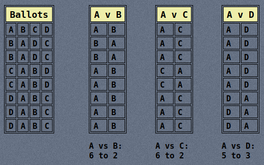

More importantly, the ballots also show (paradoxically) that a real runoff between candidates "A" and "B" would result in "A" winning the election. This can be seen here where "A" would defeat "B" by 6 votes to 2 votes in a real runoff:
A B C D   (ballot 1 - voter prefers A over B)
B A D C   (ballot 2 - voter prefers B over A)
B A D C   (ballot 3 - voter prefers B over A)
C A B D   (ballot 4 - voter prefers A over B)
C A B D   (ballot 5 - voter prefers A over B)
D A B C   (ballot 6 - voter prefers A over B)
D A B C   (ballot 7 - voter prefers A over B)
D A B C   (ballot 8 - voter prefers A over B)
As shown here, the voters preferred candidate A over B by 6 to 2. But the "Instant Runoff" voting method "jumped to the conclusion" that A would lose and therefore eliminated A in the first round and ended up declaring B as the winner.
