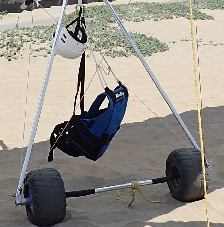

Postby Frank Colver » Sun Aug 06, 2017 9:16 am
On my Alpha I solved the slippery downtube problem by applying the narrow non-skid white tape commonly used at the edge of stair steps. I applied the tape straight down the front of the downtubes so that it wouldn't be rubbing against the shoulders when holding the glider prior to launch. It also helps grip during launch as well as during carry back.
The white tape doesn't show very well in the photo but it starts where the blue reflection strip on the tubes ends (about where the helmet is hanging) and goes all the way down to the base tube bracket.
Showing downtube tape.jpg (347.3 KiB) Viewed 11843 times
