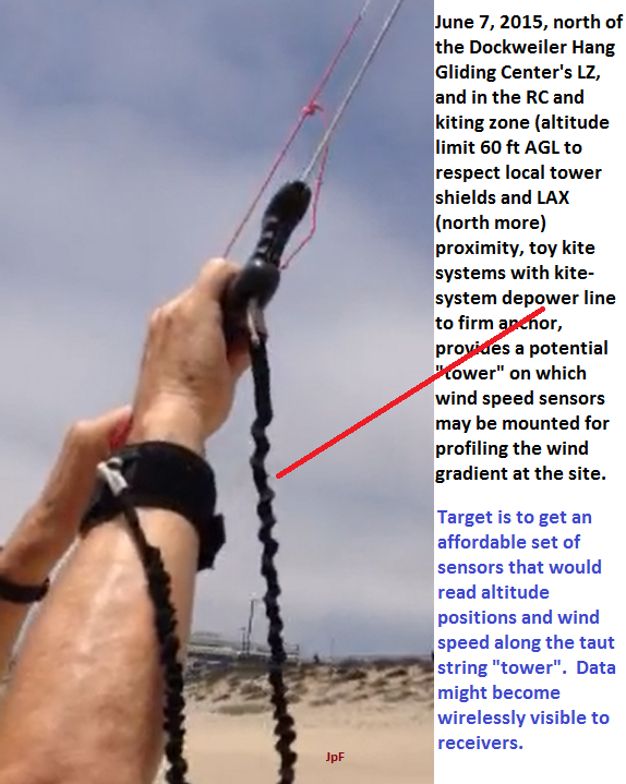

Click photo to see full tallness of the photo:
Near Dockweiler Hang Gliding Center but outside the HG flight zone:
Measuring wind gradient and its changes?
How would standardized tell-tails work? Have a set of 20 tell-tails that would flap characteristically to a certain wind speed. Then a distant visual might delight.
Maybe have some rotors that would autorotate at various speeds; the rotation rate could give data in various ways.

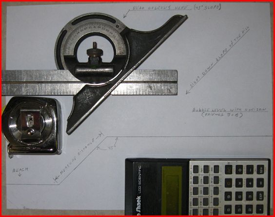

Hey Joe I forgot now the math I used to figure out the angle of a soaring slope, height and everything else but I remember (except for the numbers) how I went about it.
Tools used:
Combination angle, level, and adjustable square.
Measuring tape.
Calculator. (capable of sine, cosine, tangent.)
Bubble level with horizon. (by friend out to your side)
Sight down slope of the hill. (by you and tighten the screws to fix the angle.)
Read the angle and distance down the slope and go back thirty years to when you remembered how to load this into the calculator.
How about it Bob? Do you still remember how? I sure don’t! :roll: :?: :think:
You may have to hit control plus (+) to blow up the attachment to read it.
Measure the sand dune.JPG (46.46 KiB) Viewed 18384 times

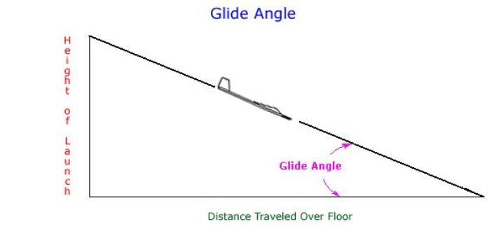

Another non-soil slope in calm air is the glide path at Dockweiler; say in full calm one gets off the launch and glides straight out toward some point on the sand; will one glide to the point or settle for a closer or further point? When going for distance in that calm, one will reach a point that is lower than the launch point; between those two points will be a relatively straight line through the calm air, but not perfectly straight, as some ground-effect occurs at launch and then again at landing; but a normalized glide path may be figured by the two points and the net altitude drop. Projected distance (zenithal shadow of the glide path) is a number; this is one leg of an involved right triangle. Knowing the altitude drop from launch to the landing is the other leg of the right triangle.
E.g., say Dockweiler is 25 ft at launch ---above landing altitude. Say floor distance traveled is 175 ft. Let G be the glide angle: tangent G= 25/175= 1/7= 0.143 approx.
Another method is to use your angle method; get the angle of glide using the level sighting. So, get G by that method; say the arc read about 8 degrees. Then tangent (8)= 0.143 approx.

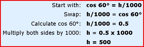

Find heigth knowing hypotenuse and slope angle.JPG (7.33 KiB) Viewed 18347 times
How to.JPG (29.84 KiB) Viewed 18347 times

So, with that method, to know the "1000" or equivalent hypotenuse, one could at Dockweiler get a string from landing point to launch point; make the string taut. Neglect the small catenary. Measure the string. Then from your first post get the angle from down vertical to the glide path, to match what the 60 deg was playing in your example drawing. Then the h could be determined. Since Dockweiler is about 25 ft in first guesstimate from June 7, 2015, then playing with about 82 degrees, cos 82=0.139 approx. 25/s=0.139 for 25/0.139=s for s=180 ft approx. So, we would need a working string of about 200 ft with markings at each foot in the region likely to be used, longer if anticipated glide is better than about 7 to 1.
Then, one sets up your inclinometer at launch or at landing to get the angle wanted. Then stretch the string from landing to launch point; mark the string; read the length of the hypotenuse. Then calculate the height of the launch above the landing as above for h.

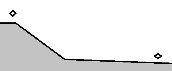

Measuring the Dockweiler launch height over landing height by indirect method:
This method needs a level handy segment at the LZ; at each end of the handy level segment, take individual angle readings.
Trigonometry - Find the height of a mountain. MathematicsClass.com (10b)
Once the height of the launch is known well, then that h may be used to find the glide angles of real flights; see posts above by BillC and Joe.
