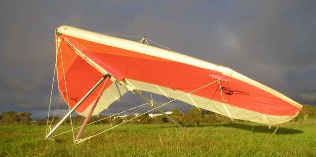

I've been thinking about building a small lightweight demonstration glider for a while now. The goal is something that pretty much looks and feels like a real glider but is smaller and lighter in weight so it can be taken to public areas and easily handled by non pilots with a little supervision. The size should be small enough so that it's not too hard to ground handle in moderate winds, and it should also support hanging people in a regular harness so they can see how comfortable it is (no "hanging on" required).
Fortunately one of the Hawks members donated a glider just right for this project (thanks Dino!!). It's a small Moyes glider (around 130 squares) that I was told shouldn't be flown again, but it looks great. It's also got relatively small airfoil shaped down tubes which are comfortable to hold.
At this point, I've cut the sail and sewn the lower surface together at the zipper, but it may have to be re-done to more properly fit the frame. This particular leading edge has multiple sections, so I've got some work there to pick the right parts to make it lightweight and convenient.

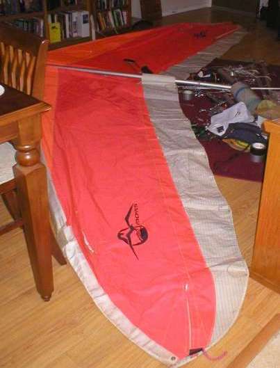

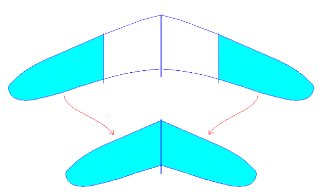

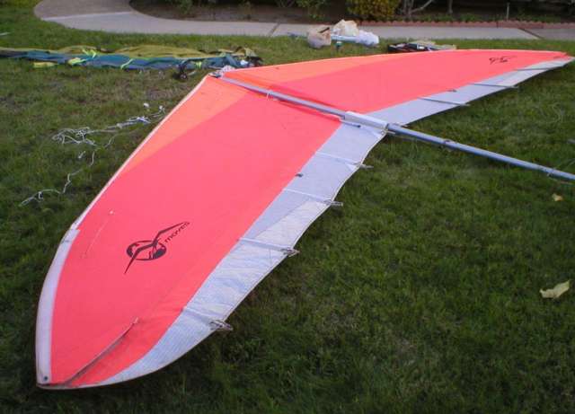

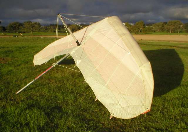

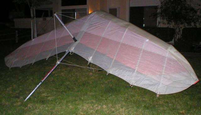

Here are some diagrams and photos from the project so far:
Any thoughts and suggestions are welcome!!

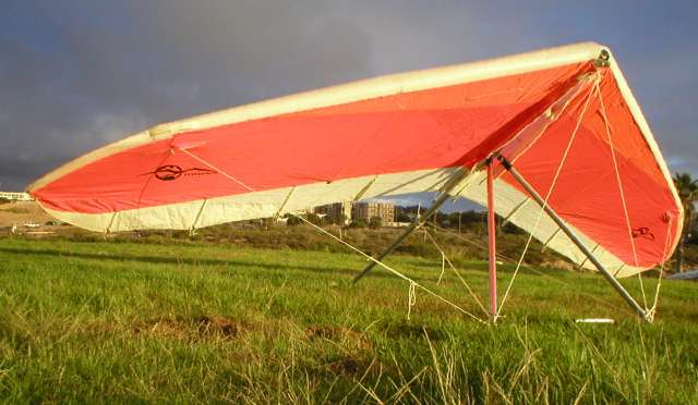

The previous photos were taken with the sail loosely fitted to the frame. Over the weekend, I got some great help from Mitch, and I should be able to start putting it all together in the next few days.
This is an exciting project, and I can't wait to start putting this little glider into people's hands. In the past, we've used my full-sized Falcon 195 (featured at this 2009 fundraiser), and a lot of people enjoyed it:

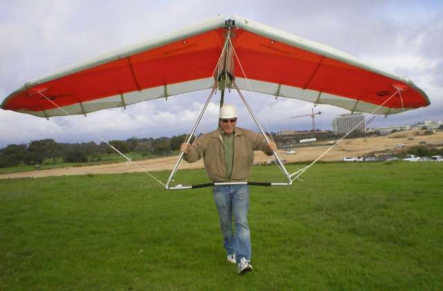

That glider was so small and light when packed up that it felt like a beach umbrella that I could tuck under my arm. The one I'm building now is a bit larger, but it's still small enough to fit inside my minivan so I can always have it with me. I made it larger than Joes with the hope that it might be able to lift off someone's shoulders when running into the wind. I learned that trick from Kenny who loves to have tourists do that with his glider at Torrey. They really enjoy it and it makes for great outreach for the sport.

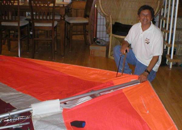

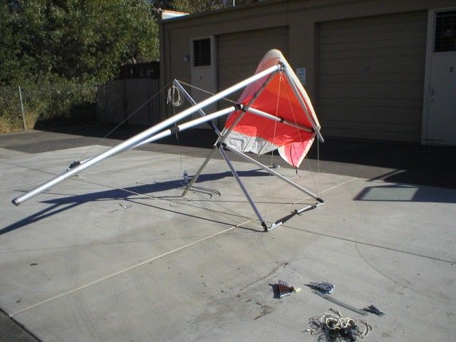

Here's an update on the little glider after last weekend's work ...

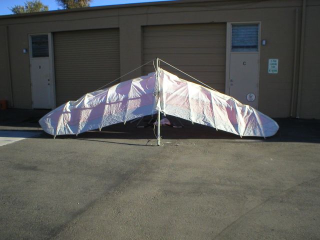

Let me start with a full picture of the glider in majiemae's living room:
File comment: Full Glider
Here's a picture of myself while making the crucial "point of no return" crossbar cuts:
File comment: Preparing to cut the crossbars

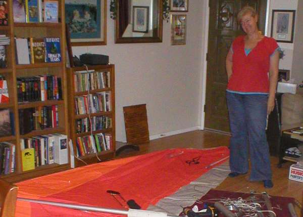

Finally, here's a picture of majiemae wondering what she's gotten into:
File comment: A hang glider in my living room?
Overall, the project is coming along great. I've been going slow because it's always easier to cut too little too often than to cut too much ... even once!!
One of the big problems was with the tip wands. They were very very stiff and they put tremendous stretch on the small sail when tensioned. I think with the larger (original) sail, there was more stretch and give (across a larger area) than on the smaller one. So I struggled with some way to get less force from the tip wands. Eventually I decided to visit a used sporting goods store ("Play it Again Sports") to look for either fishing rods or golf club shafts. It turns out that they had used drivers for less than $10 each, so I bought a couple with carbon fiber shafts. The diameter was too small for the tip wand cups, so I built them up by winding duct tape around the ends. Other than that, they ended up being perfect. They're lighter weight than the originals, and they take far less effort to tension. However, I wouldn't recommend them for anything that actually flies!!! :shock:

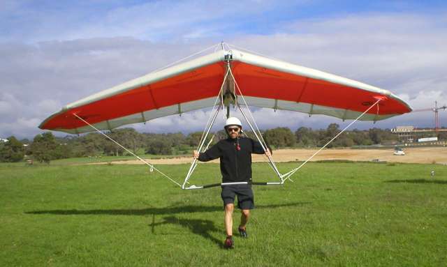

Well, tonight I finally got to run with the glider. It was strung up with ropes (and not wire), but it was still pretty cool!!
I started the day with a "legless" glider (no control bar or king post) ...
File comment: A Wing without Legs

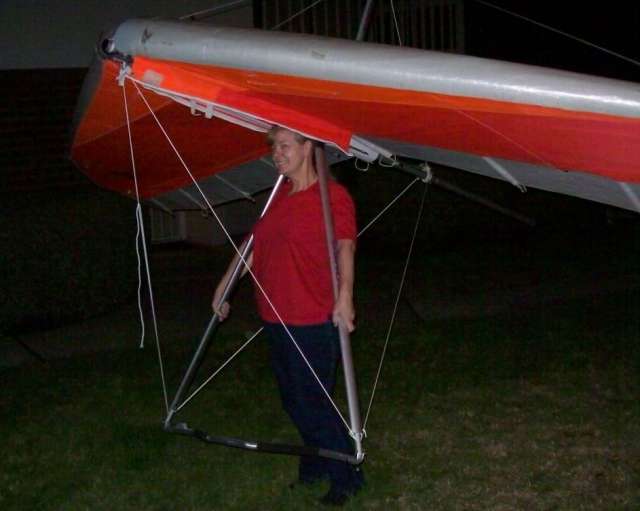

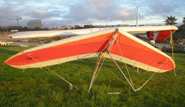

Throughout the day I found the static balance point ( :) ), cut the hole for the king post ( :| ), punched holes for the top wires ( :? ), installed the control frame ( :shock: ), and "strung it up" with some rope ( :o ) ...
File comment: Front view of "Little Hawk"
File comment: Top view of "Little Hawk"

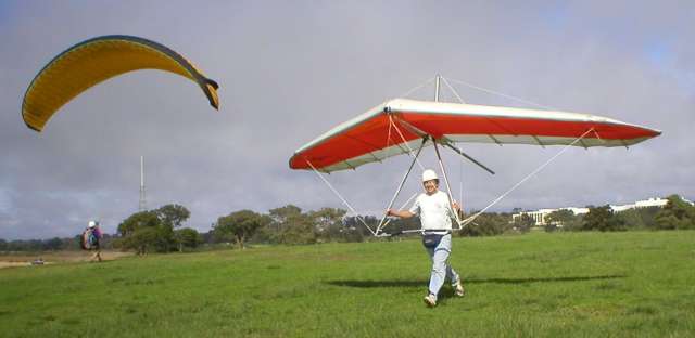

By the end of the night, I was running with it ...
File comment: First "flight" of Little Hawk

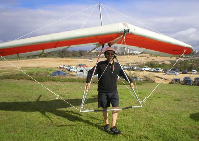

... and already using it as a demonstration!! ...
File comment: Your hands go here...
File comment: Little Hawk is lightweight and easy to handle!!
The goal for this project was to create a small (about 50 square foot) glider that fits inside a minivan and is lightweight and easy to ground handle (for demonstration purposes) by people who've never touched a hang glider before. So far, it looks like all those goals will be met. The current glider still uses ropes (instead of wires), but after I do a little more refining, I think it will be ready to have a set of wires made.
I decided to call the glider "Little Hawk" in honor of all the Hawks members who helped. I was originally going to name it after Dino for donating the glider. But then I got a bunch of help from John, followed by a really super session with Mitch. Then Stack contributed some frame parts and Margie helped with the construction. I can't even keep track of everyone who pitched in with a hand or a suggestion. So rather than call it "Little DinoJohnMitchStackMargieErnieSteveDave...", I went with "Little Hawk". But that doesn't diminish my thanks to everyone who helped. Maybe I can get you all to autograph the sail!! :thumbup:

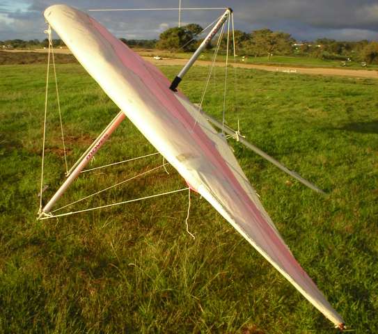

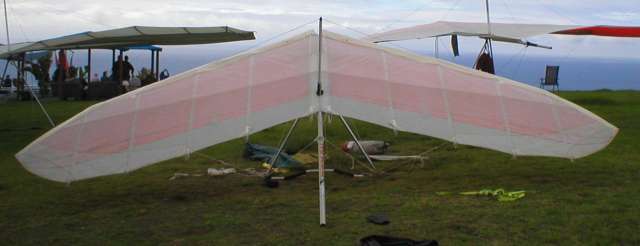

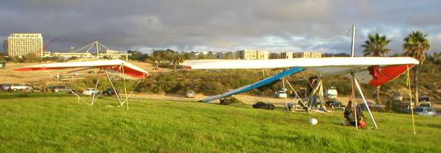

Here are some "glamour shots" of Little Hawk followed by a few size comparisons with my Falcon 195. One of the shots shows that the full wing span of Little Hawk is about the length of just one leading edge of my Falcon. I still haven't done an exact square footage measurement yet, but I'm guessing between 40 and 70 square feet. It's really a nice looking little glider, and Mitch did a fantastic job of marrying those two wing tips to make a full glider.
Here are the glider shots ...
Here are the comparisons to my Falcon 195 ...
You may notice that the glider is currently held together by string. I'm still working on the right balance and placement of the control frame before making permanent wires. I'm also running the lower side wires (strings) through an access zipper near the wing tips to avoid poking another hole in the sail until I'm sure where I want it to go. Right now the lower side wires are actually looped around the tip wands because it was convenient, but I'll have to anchor them to the leading edge at some point. Mostly I'm happy it's working out so well ... and it actually flies!!! :D

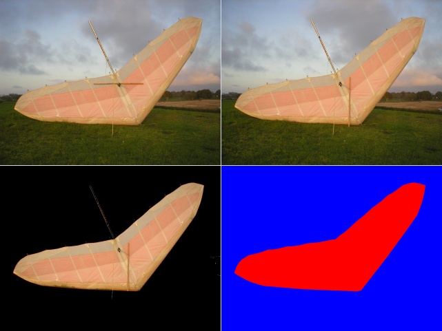

Little Hawk Measures in at 65 square feet!
I took Little Hawk out to Torrey again and tipped it up for some planform photos. I used a bamboo pole for "calibration" which I later measured to calculate the area. The top two photos show the bamboo pole used to calibrate for horizontal and vertical pixels. The lower two photos show isolation of the glider from the background and turning it into red and blue channels to facilitate the histogram.
Here are the calculations from the original full size (1600x1200) images:
Quote:
The bamboo pole is 51 and 3/8 inches or 51.375 inches (a little over 4 feet).
The horizontal bamboo pole in the first shot spans 386 - 25 pixels, or 361 pixels over 51.375 inches. So dividing 51.375 by 361 pixels gives 0.142313019 inches per pixel in the horizontal direction.
The vertical bamboo pole in the second shot spans about 393-28 pixels or about 365 pixels (there is considerable grass ambiguity). This would be about a 1% difference, and since this is a larger estimate (because some of the grass was counted as pole to estimate its full length), then the value may be smaller and the 361 pixel value will be used in both x and y. That shows that the pixels are about square (and not rectangular), and even if they weren't, the estimate should be within a foot or so.
After turning the original into a red on blue image, a histogram shows 1920000 total pixels (1600x1200). The background (blue) contains 1457502 pixels, and the foreground (red) contains 462498 pixels. Together they sum to 1920000 which is the correct number of pixels.
So if we assume that each pixel is 0.142313019 x 0.142313019 = 0.020252995 square inches / pixel, that gives an area of 0.020252995 in/pix x 462498 pix = 9366.969855823 square inches. And 9366.969855823 square inches / (12x12=144) square inches / square foot = 65.048 square feet.
I've been estimating between 40 and 70 square feet (often quoting 50) based on an estimated percentage of the wing that I'd cut off. So 65 is within that range.
