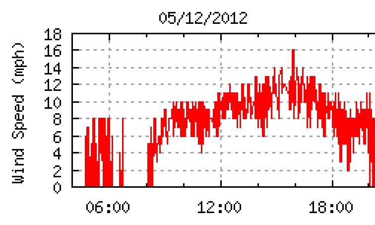

Bob, can you pinpoint on the picture where the paraglider actually went down? If it was a turbulence induced collapse, the question is, was it pilot error in failing to recover from the collapse?
I'm not exactly sure and I don't want to get "dinged" by the Torrey folks for posting anything that's inaccurate. But from the pictures I've seen of the rescue, I believe it was in (or very near) the area behind the wind shadow in that bowl just south of the mansion with the palm trees.
Jacmac wrote:
I've been approached by prospective pilots at Torrey a couple of times and they asked me about the differences between Hang Gliding and Paragliding. So I told them about the possibility of a paraglider collapse, but that a collapse was highly unlikely at Torrey due to the smooth conditions. I've never experienced any turbulence at Torrey beyond a minor bump when I hit someone's wake. If this woman was flying low and in a strong enough crosswind, I can imagine that the turbulence could get severe in certain areas if you are not far enough out.
That's pretty much been my view as well. I did my student paragliding in the mountains (Little Black, Horse, Crestline/Marshall), but now that I've got my ratings, I generally stick to coastal sites for paragliding. But this accident points out that even at coastal sites, there are dangers.
By the way, the directional graph above only shows one part of the picture. Here's the wind speed during that same period:
Remember, of course, that these recordings are from the Gliderport itself (I believe) and the accident site was a little south. So not every little bump in either graph can be taken as accurate at the accident site. Having said that, those winds are fairly strong, and it's possible that there was some significant rotor or other mechanical turbulence in the area of the accident.

They are saying that the wind was due West with some South component at times.
They could really benefit by seeing Bob's charts on the wind direction and velosity, and approximate location.

The conditions were nearly ideal 9 - 10 MPH winds out of the west with, I believe, perhaps a small southerly component.
I captured the wind history from the local site and published a brief analysis at the US Hawks Hang Gliding forum:
  http://ushawks.org/forum/viewtopic.php?f=4&t=1031 (scroll down to the wind plot and image of the site)
From the wind history and the cliff configuration (shown in that topic), I believe it was a northwest wind that may have contributed to the death. Those conclusions are certainly not definitive, but they might help shed a little more light on what happened. Any feedback on that analysis is welcome, but please remember that I'm currently limited to one post per day on this forum ... so please be patient.
