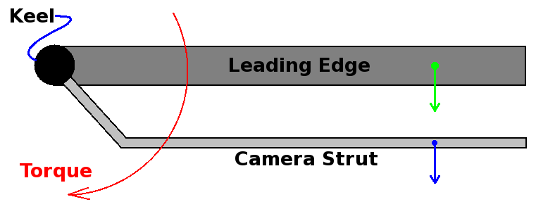

Bob Kuczewski wrote:
ZackC wrote:Last year I went to a clinic in Utah hosted by Ryan Voight. Ryan's into aerial photography and on a down day we were discussing camera mounts. He had a mount that attached to the base tube and extended out a ways in front of the pilot pointing aft. He said you didn't have to counterweight it because as far as the glider was concerned all the weight was on the base tube where the mount attached. I wasn't sure about that and Ryan isn't the most trustworthy source with regards to physics but he apparently had experimental verification that was the case so I went with it. It never occurred to me to apply that same principle to our hang points.
If the situation was as you describe it, then Ryan was absolutely wrong (or you misunderstood what he was saying). The torque applied by a weight attached forward of the base tube does affect the glider. He may have gotten away without counter-weighting because it was relatively minor (torque is force times lever arm ... as in "foot pounds"). If the arm wasn't too long, and the weight was relatively light, it might have been unnoticeable, but that doesn't mean it was zero. More importantly, a statement like that can plant dangerous misconceptions in his student's minds.
ZackC wrote:It's well known that if you put a heavy camera on a leading edge out near a wingtip it will cause a roll tendency. If the camera was in the same position but mounted to a beam attached to the keel at the hang point instead of the leading edge it would not (I think). If that's the case, the actual shifting of weight that occurs in a roll can't be the cause of the roll because the pilot is still attached to the same point on the glider. For a true weight shift roll to occur the hang point would have to move laterally.
This doesn't sound quite right to me. I believe the camera attached to the beam from the keel will still impart a rolling torque on the glider. Also, when the pilot shifts, his hands are applying a torque to the glider through the base tube (or down tubes). That's what allows him to shift his weight in the first place. So you can't really separate the two. You may be confusing this with a tow line situation where the force is just along the line because that's the ONLY connection between the glider and the tow force.
ZackC wrote:Even if I accept that shifting weight isn't responsible for a glider's response, there are still some things I'm not clear about. The control frame is fixed to the keel...what causes the left wire in your example to tighten? What causes the slop transference? If the roll is caused entirely by wing warping, how does differential wire tension effect pitch changes (which, to my knowledge, are not caused by wing warping)?
I think weight shifting is responsible for the glider's response. I believe that shifting weight applies a torque to the glider through the pilot's hands which is rolling the glider. The interplay between the torque and the wing warping is a little more confusing, but I believe that the torque is the prime mover in this situation.

Postby Frank Colver » Wed May 11, 2016 11:46 am
It physically doesn't matter where a mass it attached, it is the position of the mass itself that determines the CG of the object it is attached to. Attaching the weight of a camera to either the LE or keel would make no difference if the camera itself is in the same position in relation to the rest of the glider. That is why shifting of the pilot's weight affects roll and pitch even though the hang point attachment doesn't move.
There is no magic in physics. ;)
FC
Re: Fatal hang gliding accident
Postby Bob Kuczewski » Wed May 11, 2016 1:08 pm
Frank Colver wrote:It physically doesn't matter where a mass it attached, it is the position of the mass itself that determines the CG of the object it is attached to.
Frank is correct. This sketch (viewed from the rear of the glider looking forward) might help:
It doesn't matter if the camera is attached to the leading edge (top - in green) or some camera strut or "beam" (bottom - in blue). The glider will feel the same amount of torque applied about the keel ... at least when the glider is horizontal (when the glider is rolled, the vertical offset between the two positions changes the horizontal offset as a cosine of the roll angle).
Pictures speak a thousand words, and I think if Zack were to consider applying a downward force on either lever arm in the picture, he would conclude that the rolling force would be the same. Sometimes words can confuse the matter and that's what I think has happened here. That's why I stated: "If the situation was as you describe it, then Ryan was absolutely wrong (or you misunderstood what he was saying)". Of course, it could be a little of both.
