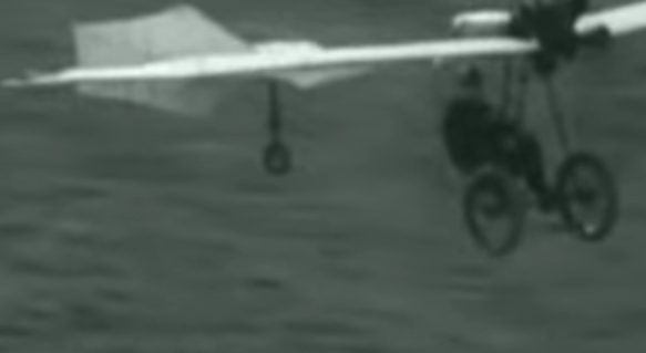

Postby JoeF » Sun Nov 22, 2015 3:13 pm
Grade again, 1909, clip from news video.
Screen Shot 2015-11-22 at 2.07.58 PM.png (138.74 KiB) Viewed 8656 times
