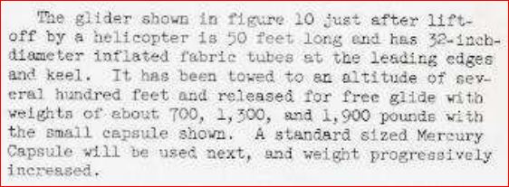

Re: Inflated Aircraft
Postby JoeF » Sat Feb 06, 2016 6:05 pm
In a report of 1962 by F. M. Rogallo:
LE and Keel: 32 in diameter inflated.
