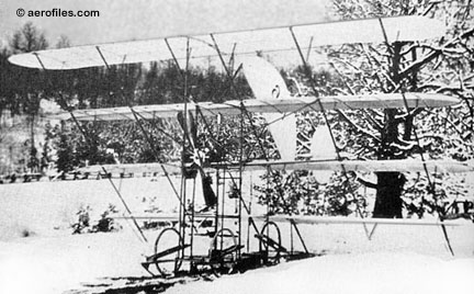

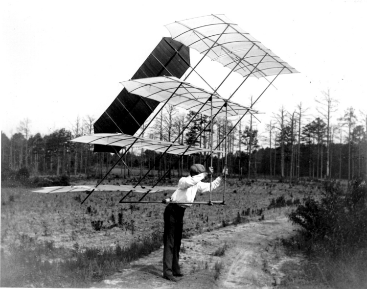

Sellers quad-wing hang glider
Matthew B. Sellers, patent 1908 https://www.google.com/patents/US927289
This is in the direction of one of my "city-street" hang gliders; but I aim to arrange a Safe-Splat device for skid-braking on city streets with downhill landing on the asphalt surfaces. 20-ft span for lower first wing; upper wings span going to 21 ft, 22 ft, 23 ft. perhaps; time will tell. I am aiming for carbon fiber framing. The Dockweiler site should feature such a quadruplane on weekends. Maybe I will go for "5" wings :) :?: :idea:

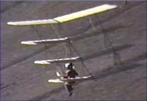

Notice the differences of ruddering between Sellers of 1908 and of Hall of 1978.
And compare the airfoils: Sellers with thin while Hall with thick.

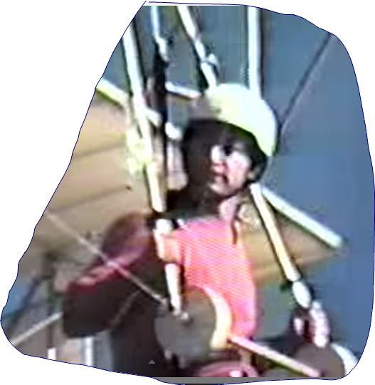

(recall later Larry Hall quadrulane hang glider) "This is a Quadruplane Hang Glider designed and built by Larry Hall around 1978."
Hall arranged tether-hung pilot and triangle control frame (echo mechanically for control arrangement of 1908 W. Simon, at least).

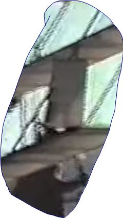

I do not know the pilot in the Hall clipped image.
