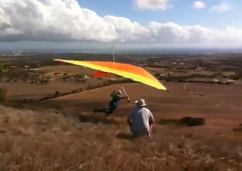

Also, in one of the posts, Tad links to a video of a pilot launching unhooked. Fortunately, he's not hurt. Here's the link, and a snapshot from the launch:
http://www.youtube.com/watch?v=2mX2HNwVr9g

Last weekend this Aussie here in Western Australia (not me) who launched unhooked was lucky not to hurt himself, just his pride. Goes to show us Aussies are far from perfect, still happens here as well.
Hang Gliding Crash - Don't Forget your Hang Check!
2011/04/24
Yeah. The Magic Land Of Oz... Where there's an entire - albeit small - continent of people totally incapable of conceiving of a situation in which a pilot could be at launch under a glider that he's not hooked into - so NOBODY *EVER* does or looks for a hook-in check.
In this case there's a pilot, a couple of observers, and a cameraman.
1. I'm starting not to care. Most of these people that do this have probably had access to the critical information and have chosen to disregard it - for years.
2. And I haven't heard this guy getting on the wire - which he should have an hour after he got home and took the glider off the racks - and making an effort to keep the same thing from happening to someone else on a harder, steeper slope.
3. And I'm also noticing that Ido did NOTHING by way of responding to my contact to keep Perth from setting himself up for a rerun.
That's not the important part of the video. The important part of the video was the very first two seconds before the glider starts moving forward. And they're not about what happens but entirely about what doesn't happen.
For the purpose of the exercise this was a KILL - the second of this flavor we know about in the space of a thirteen day period (and the previous was an actual kill).
So are we gonna hear any chatter here from anyone besides me and Bob about making sure we and our fellow pilots never assume they're hooked in at the moment of launch? We're WAY overdue for another US fatal (as if another Bille Floyd wouldn't be plenty bad enough). Are we gonna do something before something happens AGAIN or are we gonna wait for the next "wake-up call" to briefly fire up our microscopic attention spans?
