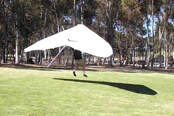

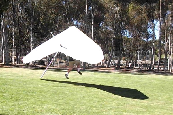

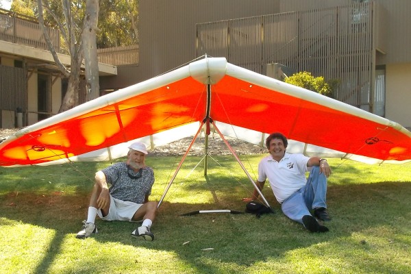

Willy and I took Little Hawk to UCSD for some local outreach ...

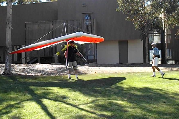

We started with a few demonstration flights (no harness)

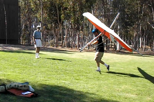

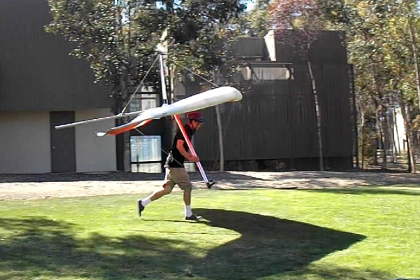

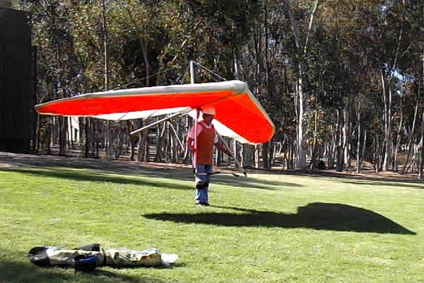

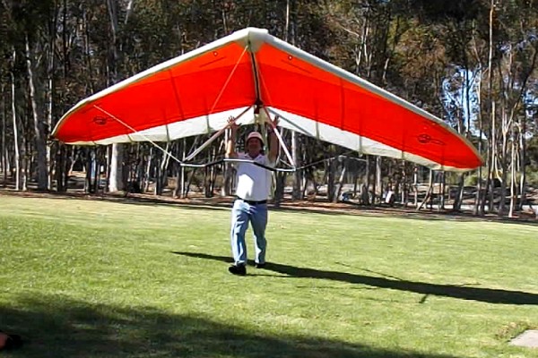

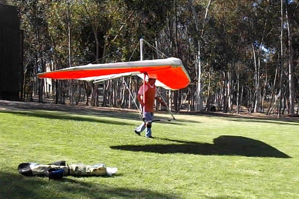

Then it was "hands on" for the students ...

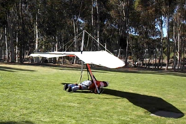

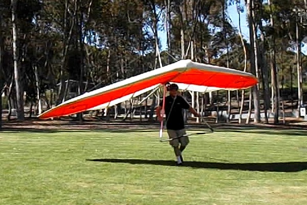

Finally, I demonstrated the harness with the glider ...
It was a fun day.      :thumbup: :thumbup: :thumbup:
