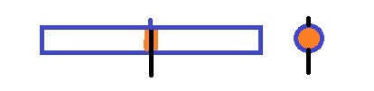

More development notes on a coupler:
"post flange" to receive chordwise strut extension ...
The post will stop diagonal stays.
"Strut extension enters main strut to be stopped inside main chordwise strut ..."
Fly and land rig lines' terminal loops could wrap coupler and be stopped by the post that receives the chordwise strut extension.

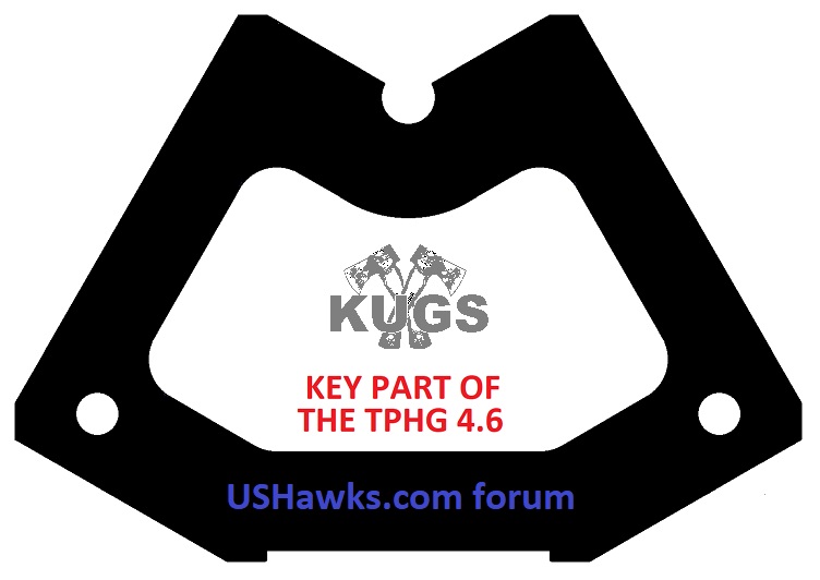

I'm also trying to make a new frame without crossbar nor bowsprit. First fly a small slope, then see.
Blueprints are at the machinist shop, delivery planed for middle of August, anodysing and go to make the sail at the end of August-September.

Postby Semper Fidelis » Wed Jul 10, 2024 3:44 pm
I'm not going to comment this part yet, but it might be interresting to see your comments :wave:

Key part of the TPHG 4.6
Semper Fidelis

Bob Kuczewski's offer of the Alpha 210 and hacksaw was a doable TPHG 4 or 4.5 or 5 solution that would have been a heavy-for-my-choices event; but the project still might tempt someone.
Could KUGS' teased part be a __________ :?: :idea: ___________ :?: :?: :?:
????: deflexing support in a non-bowsprit-non-crossbar solution??
????: Bracket to support airfoil-forming line??
Comments by Florian indicate to me a strong bent to accept a final mass that for my aims might be a no-go for happy bus-and-hike. The volume of a toted solution could be large or small or tiny; length of "in-car" solutions and happy-polite-safe-busing solutions may well be close, but the handling could be quite different. The total mass of an "in-car" solution could be quite different from a hiked-city-bus-polite-safe-to-be-in-bus-crunch solution. Many types of solutions form the openness of this topic thread.
