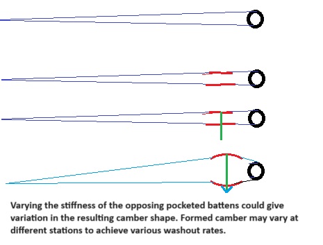

Postby JoeF » Wed Jun 05, 2024 3:58 pm
Note about a method to give DS camber: have two opposing short battens of variable stiffness, one in upper skin sail and one in lower skin sail. The lower pocketed batten will have a hole in its center; and a small tethered cap will be near the hole. Poke a CF small tube through the hole and press the penetrating tube against the upper batten where a small toroidal receiving mound will be felt by the person assembling the hang glider. Then place the tethered cap on the lower end of the penetrating tube. This will force camber in the wing at that station. Do similarly at many stations. The method offers means to vary camber when all parts are designed just right. Variations on this method could be explored.
Postby JoeF » Thu Jun 06, 2024 7:31 am
More about former post matter:
The two opposing battens may vary greatly from each other to get different shaping results. An an individual batten may be made with variations along its chordwise material to achieve various effects. E.g., consider a top batten to be tapered or feathered to soften the rate of curvature when pressed while the opposing bottom batten could be stiff compared to the upper batten in order to flatten lower sail alteration when the pressing tube is set. The poking tube could be pressed and set in position by a small tethered cap; varying the length of the poking tube or varying the tethers of the position-setting cap may result in variations in the effected camber. Battens may be replaced varied battens for more change options. Battens could be wide or very wide. Many experiments await. The scheme allows full separable disassembly for high density packing for transport. By careful choices the upper camber could be very different from the lower camber. :idea: :?: :idea:
Suppose SS, not DS? The above scheme may still be explored by having taut lower chordwise lines from rear spar LE spar; then set the poker tube on the line while the upper end of the poker tube presses the batten set in the single sail. :idea: :?: :idea:
The present noted scheme is a type of "stuffing" to help form airfoils. The poking tube is the stuffer in this scheme.
Note: Explore the possible special advantages that may occur when the "batten" is broad spanwise and is pressed by several pokers.
Note how battens can be taken out of sail pockets, how poker tube is separable, how operating the scheme is from the underside of the wing, and how great the variability is to achieve something among infinite options (though we have only finite options that could ever be tried)
Notice that batten pockets may be long or short and may be positioned anywhere on the wing covering.
Notice that poker tubes may be short or longer.
Notice that a poker tube could be V formed and connected with a control line; pull on the hinge part of the poker V and control the aerodynamics of the wing.
