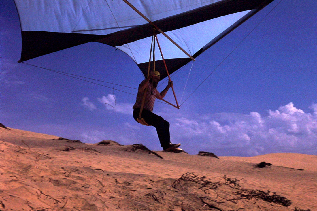

Hmm.....comfort, it sure looks like it beats the Sears swing seat. :)
Great flying site you have there :!:
My Eipper FlexiFloater 1974 Cantamar Mex.
me at Cantamar 1974.jpg (484.17 KiB) Viewed 5569 times
