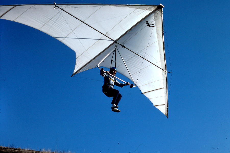

As to the suprone position - I like the idea. I had always flown seated even long after everyone else went to prone because I love the seated flying. The disadvantage, as has been stated, is that the legs are under the bar. However, in some typically nasty landings, a few times in my years of HG, I never was injured by that fact. I always managed to get my legs back underneath me before the splat. And, I never even came close to hitting my head on the keel tube.
Here for nostalgia's sake (1970's) is me in my favorite flying position where I can enjoy the look around and not get a stiff neck either. Hmmm....wish I was still that thin.
Good points Frank but basically quoted you to say I LOVED my SSTs!!!! I had two of them...Talk about a forgiving ship...And yes....wheel on the Base tube...pilot above the base tube....a Bar in front of the pilot to pull in from....two main Suspension straps that will hit the suprone bar first in the event of a bad landing and soak up the initial Gs.....then the pilots body has to crash THROUGH a bar attached to both downtubes and take out all that aluminum before swinging forward....THEN the pilot legs are going to absorb what Gs are left over to absorb....NOT the pilots head....
