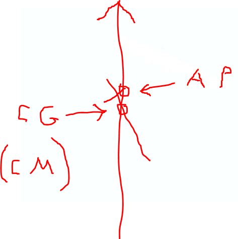

Postby Bill Cummings » Sun Jul 24, 2016 5:02 am
Rick>
Your line of force will be the trajectory of the pilot's mass.
You might get 8 inches L with him angled this way, or 0 inches L with him angled that way.
It's not just an unknown, it's a variable. You can't depend on it. You can't design for it.
Thanks Rick,
I can see it now.
0 rotation.JPG (21.79 KiB) Viewed 4769 times
CG or CM = center of pilot mass.
AP = Attachment point.
If they line up there will be no rotation.
__________________________________________
But could the same be said of the one sided ARP restraint to the corner of the control frame?
Posts: 3360
