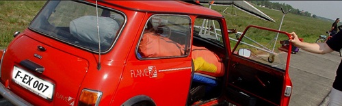

From what I read Bautek is a successful German Hang gliding manufacturer that had series of shortpack gliders that they currently maintain but no longer sell new models as the used market provides enough supply.
https://forum.hanggliding.org/viewtopic.php?t=24201
Infomation from the link above states that the Bautek may have had telescopic leading edges but this cannot be verified.
Are there any videos or drawings or pdf vfiles that show how these glider are set up?

I've not found yet any verification of the "telescopic" spars of Bautek. Be ready for short intersleeving as compared to long telescopic insertions.
Their "short pack" is longer than the packs in high focus in this topic thread, but one may learn from anyone's effort to short pack, even if tiny pack is not achieved.
One online Bautek text quote: "you can easily short pack them so that they fit into every garage!" The "garage" invite is large compared to "tiny packing.
, I'd surmise." Bautek comments about the bowsprit Astir: "Transport and storage present no problem as the Astir has a short-pack length of 3.00 m (9.8 ft); it therefore fits inside most station wagons." That has a focus that is about twice the size of the tiny packing of this topic thread's maximum; some of us are even aiming for 1 m tiny packing or less; that would put the Astir at about 300% of a 1 m target for packing.
The "Packing the Airfex / Funfex / Perfex / Lightfex short to 1,90 m" video bespeaks and demonstrates 1.90 m "short" packing that resolves the needs of many pilots, but that is about 200% larger than the 1 m in focus for a faction of seekers related to the present topic thread. The Finsterwalder-Charly https://finsterwalder-charly.de/en/hang ... ories.html "short" packs are certainly with pleasant histories and stories of fliking (fly and hike).
What might we learn from the 1.9 m for the shorter tiny-pack movement?

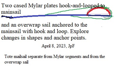

For some HG experiments cased Mylar forming captive columns may be set on a taut mainsail and then overwrapped with a second sail to achieve various airfoils.
Postby JoeF » Sat Apr 08, 2023 9:41 pm
Re: prior post:
The semicircled cross-section of bent Mylar sheet may be form set at HG assembly by one of many methods. Those methods may be noted for selection. Other movement workers may provide methods not found mentioned below:
:arrow: Full textile case that forces a limit of form.
:arrow: String tie LE edge of Mylar to LE of HG. Then string tie rear edge of the Mylar sheet to the mainsail using strings perma-set into the mainsail, perhaps. Holes near the rear edge of the Mylar could be used to tie the Mylar sheet.
:arrow: Have a large-mesh light net secured to the front edge of the Mylar sheet; tote such as such; then at assembly tie rear edge of that net to the rear edge of the Mylar sheet and thus forcing the captive semi-circle form of the Mylar sheet.
:arrow: Have a set of string loops ready to be placed over castle towers notched into the edges of the Mylar sheet. The loops would have a length that would force the semi-circle form.
:arrow: Have a set of holes near the edge of the Mylar sheet. Have a set of strings that have a rotatable T tip that locks naturally after inserting into the holes. The settled lengths of the strings forces the semicircle form of the Mylar sheet. "barbed strings" These barbed strings could be removed at packing. Alternatively, the set of strings could be permaset on one edge of the Mylar sheet while have the other end of the strings barbed for poking through the rear edge of the Mylar sheet (having a set of holes in the sheet) for a T anchoring as the barb rotates naturally. ChatGPT helps out here: "The strings you are referring to are commonly known as "barbed cords" or "barbed strings." They are also sometimes referred to as "locking cords," "barbed ties," or "security ties." These types of strings are often used in various industries for securing and fastening objects such as tags, labels, and bags. They typically have a plastic or metal barb at one end that is designed to lock securely into a hole or slot, holding the object in place."
:arrow: A method that does not need hook-and-loop to secure the upper and lower semicircle Mylar forms to the leading edge of the HG wing: perma-string tie the front edges of the upper and lower Mylar sheets. When wrapping the overlap sail part one may find that the two string-joined semi-circular forms seat firmly to the LE of the wing. Still, the overwrapping sail may be secured to the taut mainsail using hook-and-loop aft of the LE a good distance.
