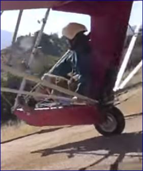

Lazair frontal bulbous wheel wrote:To start at the moment, just a meditation over a clip from a Lazair:
