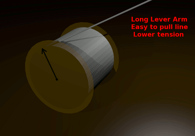

Creep in weak-link strength.
Some things that can cause creep in weak-link strength.
If the problem is at the winch/reel the remedy is not of necessity at the weak-link.
Did you know that as you pull more line off of the winch/reel a simple payout system will increase the line tension as the rope diameter on the drum gets smaller?
This is understood by the long time platform tow pilots but for those that haven’t stopped to think it through yet I have come up with this analogy that has worked for me in the past.
Let’s say your winch/reel doesn’t have any towline on it yet.
Let’s say your winch/reel axle is now visible because there is no towline on it.
Let’s set (SET not say) the brake pressure so that the brake pads hold the caliper so that you cannot turn the winch/reel without a pipe wrench on the axle.
Depending where we grab the pipe wrench handle either down close to the pipe wrench jaws at the axle or at the other end of the pipe wrench handle away from the pipe wrench jaws, which choice will make it easier to turn the winch/reel against the brake pads?
If you said it would be easier to turn the winch/reel by grabbing the pipe wrench handle at the end farthest from the jaws you are now on the same page as the long time platform tow pilots.
Put your first layer of towline on the axle one wrap deep. If you pull until the winch will turn it will be hard to turn the winch/reel against the brake. Once you have all four thousand feet of towline on the winch/reel the top wraps will be farther from the axle and it will be easier to pull the line off against the brake. Kind of like grabbing the pipe wrench higher up on the handle.
Pretend your significant other bought you a brand new winch/reel and four thousand feet of towline. Wow! Are we going to get high or what? Probably not right away. Your troubles await you!
If your towline is wrapped snugly around the drum with each wrap against the previous wrap it will payout with a minimum of abrasion. This assumes that the line is coming off of the drum perpendicularly. Coming off at an angle will cause abrasion while increasing the tension above your desired setting.
If the line is wrapped loosely with many layers deep the line will dig into the wraps which will increase line tension from friction and possibly nest stopping payout.
This can cause a weak-link to break.
In this situation the problem is not at the weak-link.
Remember that not only does the digging in of the line cause more friction against the towline creating more line tension for the pilot but the line is being pulled out from a smaller diameter as was discussed earlier. Two things that increase the tension to the pilot. A double whammy for weak-links.
Pulling off at an angle gives you the triple tension whammy. Any one or combination of whammies will break a proper, safe, weak-link.
Once a winch/reel momentarily stops paying out there is also a fourth tension whammy called inertia. Depending on the weight and size of the drum this inertia can be just a little or a lot.
If you are using towline with a low stretch value the inertia issue is magnified.
What do you think? Should we name this, inertial, shock load, tension increasing, whammy # five?
We once splashed through a mud puddle putting mud on the brake rotor. The mud dried and left grit to embed itself into the brake pads. For many more tow ups we had the winch/reel paying out line with too much line tension due to the increased friction against the brake rotor.
Is the problem the weak-link or one of several other causes or maybe a combination of causes?
Whatever the cause “weak-link creep,” usually ends up becoming the fix which in turn has you approaching the edge of the safety envelope in the direction of unpreventable stalls when tow tension is lost.

Postby Bob Kuczewski » Fri Jun 20, 2014 2:02 am
How does this look Bill?
Assuming that the braking mechanism does not change as the line is paid out ...
Re: Platform Launching (PL) Draft suggestions needed
Postby Bill Cummings » Sat Jun 28, 2014 7:04 pm
spot on Bob :thumbup:
