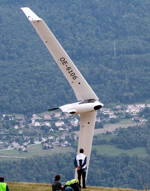

JoeF has requested we focus on the exact opposite, a 42 foot hang glider, https://aeriane.com/the-new-swift-3/ I am testing out new reading glasses option to reduce spelling errors on hang glider forums.

Doug, please ask Bob to delete the false statement that you published about my focus. I did not request we focus in this topic on a 42 foot hang glider" Rather, I hope visitors to this topic will continue the drive for 5-ft-packed-HG or near such theme. I vote that it is not helpful to radically get off topic and certainly not do so by enlisting a false claim about another person. TIA.
