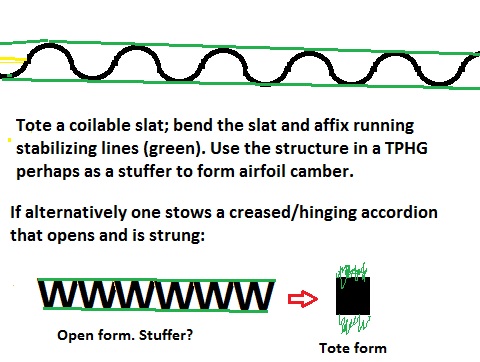

Further development notes on hoops that may play some part in some TPHGs:
With a single straight bendable slat or rod or reed or whisker and judicious use of string and some choices for cinching slat to itself, here is just a beginning of potential forms one might form from toted straight slats or the like:
Other plays:
Note: A thin long slat may roll into a helical form and cinched to obtain a stronger approximate short-depth cylinder.
Note: A single slat may receive a half twist and then cinched to itself to give an approximate Mobius strip or one-sided slat.
Note: A particular form might be oriented one way or 90 degrees from that way, etc.
