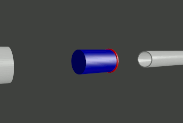

Postby Bob Kuczewski » Thu Oct 03, 2024 2:01 pm
Reduced from the animation on page 59:
One of the important things to remember is that the forces applied will be spread across the areas bearing those forces. In the perfectly sharp non-rounded version shown in this animation, the forces on the capped end would be distributed around the open edge of the inner tube. So, what is the surface area of that edge? In the "perfectly sharp" case, the surface area of that open edge would be infinitesimal (the perfectly sharp corner would have virtually no area). So if all of the compression force is distributed on a sliver of a surface (thin ring with virtually no surface area), then the force per area goes to infinity. Infinite forces are usually destructive, and nature will sometimes make up for it by stretching or deforming such that the area is no longer infinitesimal. Nature's efforts are rewarded if the materials are pliable enough (which causes other problems), but they are not rewarded if the materials are rigid (as they are in this case). So the "cup" in the animation would likely fail where it meets the rim of the inner tube.
As you mentioned, you can mitigate this problem by introducing a wider bearing area for the inner tube with a rounded plug. But then that plug must also rest on the thin inner ring or be otherwise supported. I think this can be done, but it complicates and defeats the simplicity of the original idea.
The same is true of the outer ring. Any flexible fabric will be resting upon the inner corner of the open end of the outer tube. That inner corner also has an infinitesimal surface area, so the force per area will be extremely high which tends to drive failure. The problem may be similarly mitigated by a number of methods. One method would be to flare the outer tube so that the joining material will not experience any "knife edge" of the inner rim of the outer tube. However, this encourages a further flaring as the ring will be forced into this flaring. Another method would be to manufacture castellations in the ring so that the extended portions of the ring will butt against the outer tube without forcing the joining material to make a sharp (nearly 90 degree) turn (I don't have time to draw this right now).
In either case, these additional complications undermine the beauty and simplicity of the original idea. That's not to say that it can't be made to work, but the complications may be considerably more trouble than simply accepting the limitations of a traditional cross pin (or pins).
Postby JoeF » Thu Oct 03, 2024 6:10 pm
Thanks for the page 59 and above animations! Fine contributions!
To coordinate readings across many posts on many variations of the Joe Cup, Joe Sock, Joe Strap, etc., here is some legend: Outer tube closest to keel in half-wing meta spar circumstance is with a larger OD than the smaller tube being joined by a Joe Cup or Joe Sock or Joe Strap coupling system. The receiving large tube in the join is also referred to as the Mother Tube of the join; the smaller inserting tube relative to a specific join is the Child Tube of the join. Note that later or further joins with other ends of tubes will have the at-join nomenclature of Mother and Child. Thus a single tube may be mothering on one of its end while the other end in a further join would be a child in the next join; this occurs in stepwise telescoping.
The open end of the child has a significant finite area (approximately the wall thickness of the child times the circle circumference of midline of the child's end tubular ring); that finite area presses on material, perhaps a portion of an end plug or cup (there are variations where "cup" is actually a strand of webbing appearing on both sides of the child and around the inner end of the child or the plug at that inner end. The strand of webbing acts to limit the insertion of the child. To prevent cutting the webbing with any sharp edge of the child, a plug that saves the end of the child has a rounded edge perhaps even dome rounded to receive the compression from flight loading the joint. If the valley in a child plug is kissed with a rubber ring, then the area of the end of the child presses and fully presses on a matching area of the plug's valley via the mechanics of the rubber deformation.
If the meta spar of such joins as discussed need anti-torsion, then shear pins or other means would be needed to prevent spar segments from free rotation axially. In many hang gliders the LE meta spar featuring near-tip pitch-stability devices, there is a need to stabilize torsion of the LE meta spar; serving that, shear pins at segment joins would help preserve the torsion. But in some other hang gliders where there is a fore meta spar on half-wing and aft meta spar on half-wing, torsion of the meta spars does not play a firm role, and thus the naked Joe Cup (etc.) involvement where holes in the side of the CF tube segments are avoided; such pins would perhaps also need registration care between the mother and child and maybe even registration care with gap fillers (anti-wobble material). Stepwise telescopy anticipates significant wobble prevention needs, especially when the steps are with a significant difference between mothers' ID and the OD of children.
