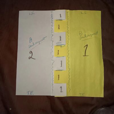

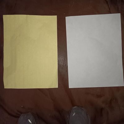

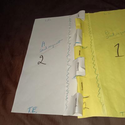

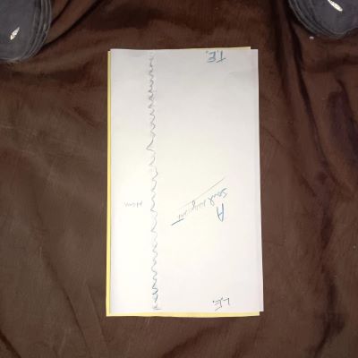

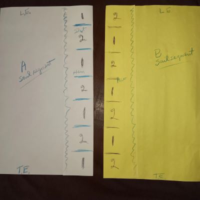

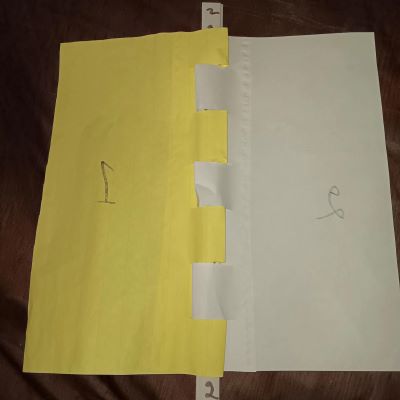

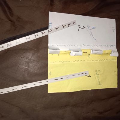

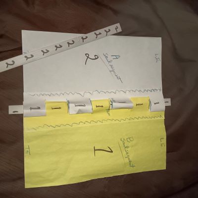

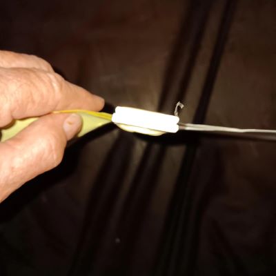

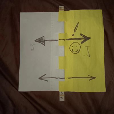

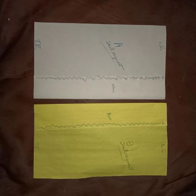

Postby JoeF » Mon Oct 02, 2023 8:29 am
1
Description of the Double-Castle Method of joining adjacent sail segments with two weaved batten-ribs probably needs some improvement. Each batten rib goes through about half of the loops of one sail edge and half the loops of the other sail-strip edge. Then the second batten rib at the same station goes through about half the loops of one sail strip and half the loops of the other sail strip. Thus each batten rib goes through a count of loops that match the count of one sail strip. This forces that the two batten ribs stack vertically (spoken as though the plane of the wing is horizontal or approximately parallel to the surface of the Earth). Looking at the result from above or below the wing, one does not see the batten ribs except at perhaps the two ends of the whole arrangement. At packing time it is super quick to withdraw the two batten ribs per join station. But at assembly of the HG, weaving the two rib battens is proving challenging, thus the invitation for brainstorming on the challenge that one finds in the prior post. :?: :!: :idea:
Suggestive mockup of Double Castle Method of joining sail segments while aiming to have no sail creases while still tiny packing the sail segments in some TPHG (tiny-packed hang glider). Placing rib-batten #1 and then #2 is a time-cost challenge; we are seeking some fast means to place the rib-battens at the flying site. Withdrawing the rib-battens is a superfast operation. It is the assembly that challenges. May creativity find some tolerable means of assembly. A TPHG might have perhaps 7 stations on each side wing; if a quick method or tolerable method is not found, then the Double Castle means of joining adjacent sail segments might not be chosen by anyone for their HG.
The eleven photos of a papered mockup is only a start of a problem-solving effort for the mentioned challengehttps://ushawks.org/forum/post ... ca61157ec#:
2
3
4
5
6
7
8
9
10
11
:arrow: :arrow: Compare Double Castle with door hinges. A door hinge has one hinge pin and captures much less than 100% of each sided flat plate. The Double Castle [b]captures 100%[/b] of each sail segment's edge being joined. :)

Postby Bob Kuczewski » Mon Oct 02, 2023 3:21 pm
JoeF wrote:At packing time it is super quick to withdraw the two batten ribs per join station. But at assembly of the HG, weaving the two rib battens is proving challenging, thus the invitation for brainstorming on the challenge that one finds in the prior post. :?: :!: :idea:
I apologize if either you or ChatGPT has already suggested this, but you might attach a thin cord to the tip of the battens when withdrawing them from the sail. Then leave the thin cord inside the joined sections when folding or rolling. Installation involves reattaching the battens to the cord and pulling them through the castellations to install them.
By the way, the double castle is very clever!!

Postby JoeF » Mon Oct 02, 2023 4:12 pm
Nice add, Bob. :salute: :salute: :salute: :salute: :salute:
Let's see what happens with that suggestion: there will be too loose strings left in the runs, one per castle run; the sail segments will still be loosely integrated, but accordion folding seems to be able to occur; there might be a light bunching at the two edges of the accordion stack; that bunching might be pack tolerable; I will experiment with that; then wrapping the accordion stack of loosely integrated sail segments around the backpack or pilot torso would be the deals.
Then at next flight session, connect the first batten rib to the helper string; anchor the sail segment strip; pull the helper string that now tows the batten rib; keep the connection of the helper string to the leading nose of the batten rib and pull the batten rib into the set of castles; do similarly for the other batten rib of that sail station. This feels real good. My notes wanted that but working rapidly I rashly rejected the path as I was forcing loose non-integrated sail segments. Your offer has us visit the deal and perhaps a loose small string in each of the two runs may not give intolerable bunching at the edge of the stacking of sail segments; the zig-zag or accordion stacking would not be of fully separated sail segments (though separable when wanted for repair or cleaning or replacement). Your cooperative offer has me excited that my rejection in notes for having a deal of non-integrated sail segments was my loss; your offer just may bring the deal back to a nice gain. Excited to try the deal out soon.
Without having the above perhaps nice deal, today I furthered some other helper means: a weak tiny U spring bonded to the edge of each loop that will be receiving the penetrating rib batten would allow smooth quick entry of a batten rib, especially if the batten rib was with a nice polished rounded conical penetrating tip. Still finding the opening at each loop in the castle set slows things. Bob's suggestion above, if all goes will, overcomes that seeking of the loop entries. The three problems of stacking and interleaving of the castles from the two neighbor edges and hard-to-enter castles (of two layers when flat) and the finding of the castle entries may neatly disappear with Bob's suggestion; that would be fun, and so worth fully exploring.
Today I proved out the fundamental Double Castle joining on a wing that was flown today under tether; the three neighbor sails joined using two stations where two batten ribs were in each station did just fine. A found tip or probably must is the following: The LE and TE of the batten ribs should be tied snug with a lashing or the like; the two LE tips of the two batten ribs should not be left to flail. Same for the two tips at the TE.
Next, during the flight session it came to me that having sail segment strips of 48" width could nicely wrap the backpack that has cross-section of 2"x12" and length of 5 feet. Such would be an alternative to narrower sail segments and human-torso wrapping of the accordion-stack of sail segments. And if Bob's batten-rib pull-string-left-in-the-castles allows for efficient pull-in of the batten ribs, then we are near good-to-go! Will try it all out soon! :!: :!:
First exploration of Bob's suggestion:
For zero overlap, zero creasing: the small-diameter helper strings stay in place with some detail cares; then the sail segments stack accordion style just fine; but the interleaving of the two castle is lost. At assembly a tautening of the loose helper strings sets up an order opportunity for getting the interleaving of castles set up; some nudging to get the interleaving enough aligned might not be onerous as the helper strings if played with some tautness will help. After the interleave is set, then indeed the pull strings (if the tailing part of the sail at that station is anchored to something; and if the nose of the batten rib is rounded and not snaggy, then the helper line pulls the batten rib through the castles (about half the castles of both sail hemmed sail segments. Detach the helper string and store it until disassembly; there will be two helper strings per station; if the HG has 8 stations for this matter, then 16 helper strings will be part of the gear and tote deal. Really thin Spectra or Dyneema fishing line would serve. Appropriate join of the helper line to the batten-rib for the pullings would be used. I think we have a winner in Bob's suggestion.
For the case when overlap and interleave is some kept while using the helper string: If the interleaving and overlap of the join is kept, then bulking and creasing become a challenge for wrapping the stack of sail segments for tote. So, in this early blush, using the above zero-overlap with very loose helper string and some loss of the interleaving of castles is winning my favor. Time and practice will distinguish matters. Get the interleaving needed may be more doable if when the helper string is made taut before the insertion of the batten rib.
Let's call the "helper string" the "Bob String"?????? Then we might have a TPHG with Joe Straps and Bob Strings! :lol: :lol:
