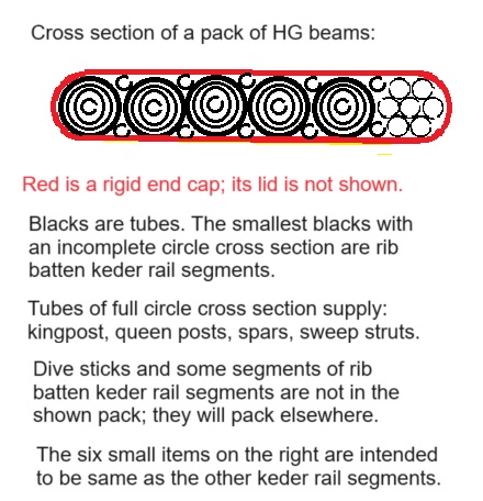

One option being explored:
Bowsprit in two or more packs: Crutch pack of spars and some rib battens. Sail packs made up of rolls of sail segments; roll core: partial rib struts; roll lengths: 36 inches; have about 8 rolls of sail segments: pack and tote in various ways, perhaps one thin pack with rolls side by side, perhaps chest tote or 4 rolls per human leg, or backpack or lap-hold-pack.
Another option being explored uses more tubing, not bowsprit. Still aiming for crutchman and auxiliary polite packs.
Several option scenes include considering no base tube but only base line in TCF (triangle control frame). And considering no macr[url][/url]o sack when crutchman is at the helm; bare the tubes to the public showing as tubes of a crutch.

This note has a focus: a means of packing five tubes and one bundle of smaller split tubes in a particular arrangement.
Have two caps shaped the same: flattened oval cap with 1" skirt that just snugs six ends of tube ends where the same-diameter tubes are side-by-side and tangent to each other and tangent to the two parallel sides of the skirted oval cap. In practice one of the tubes actually may be a bundle of seven smaller special tubes arranged tightly in a bundle; the cross section of the bundle is a hexagonal close packing of the tubes; six tubes surrounding one tube. The two caps cap the upper and lower end of the proposed backpacking of spars and rib-battens (perhaps not all the rib batten segments). The using four bungee cords kite the two caps toward each other; the two caps keep the two in an orderly pack. Then attach a suspension strap to hang the arrangement from one's shoulders during the time one stands inside a local city bus. After the bus and into trek have the arrangement be the foundation structure of a wheeled travois.

Further consideration on the backpack:
The above post suggested four bungee cords kiting two end caps to hold tubes. That alone left unbagged could pose a significant hazard to other passengers of the bus if the bungee cords let lose or a cap clipped off. Pow Pow tubes all over the bus. Big liability. Better to overall bag the tubes, but still capped and bungeed. Prevent a possible big spill! :shock: :shock: :shock:

This post will focus on rib batten keder rails.
A TPHG (tiny-packed hang glider) might use rib battens as keder rails. This might be a choice if one was wanting to segment the sails of the TPHG and use keder cord and keder rail to join adjacent sail segments to make up a macro sail. Let a sail segment be a long chordwise strip of fabric or film. Hem the long sides of that strip. In the hem insert and secure a keder cord. Then slide the sail segment edge into a keder rail; do same for the neighbor sail segment. There are various keder rail choices; use a choice. I am considering a keder rail that receives both of the keder-cord edges at once into one chamber of keder rail. A different scheme is having a keder rail of two chambers where each of the neighbor sail segments would have their keder cord in a dedicated chamber. I am favoring the single-chamber keder rail for possible weight savings, simplicity, and DIY-keder-rail making from stock tubing by cutting a longitudinal groove in the tubing.
Feeding the two keder-corded edges into a single-chambered keder rail may be accomplished using the assist of a puller string while anchoring the TE of the sail segments; a tension is set up while pulling the keder rail onto the pinched-together-fed-started sail edges.
The slit or groove made in the DIY keder rail should be polished smooth so sail material does not snag at all. I will look for COTS split tubing in Al or CF for polished opening. The groove or slit must be sized to be not too tight and not too loose. We do not want the keder cord edges ever to escape the keder-rail chamber during flight. And one would want to reduce
