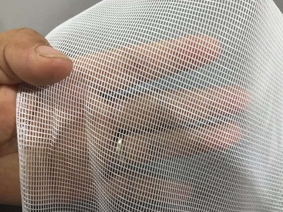

Tease study: white mosquito netting
Tulle fabric exploration for lamination experiments:

User
DIY laminating Mylar film to light fabric netting?
ChatGPT
Laminating Mylar film to light fabric netting can be a fun and creative DIY project, often used for crafting, costumes, or decorations. Mylar film is known for its reflective and shiny properties, making it an excellent choice for adding a metallic or futuristic look to your fabric netting. Here are the steps to laminate Mylar film to light fabric netting:
Materials you will need:
Mylar film
Light fabric netting (such as tulle or mesh)
Scissors or rotary cutter
Clear adhesive spray or double-sided tape
Iron and ironing board (optional)
Pencil or chalk (optional)
Ruler (optional)
Steps:
Prepare your workspace: Clear a clean, flat surface to work on, preferably a table or a large cutting mat.
Measure and cut: Lay out your fabric netting on the workspace. Determine the size and shape of the Mylar film pieces you want to laminate onto the fabric netting. You can create patterns or cut the Mylar into specific shapes as desired. Use scissors or a rotary cutter for precise cutting. It's a good idea to mark the Mylar film with a pencil or chalk before cutting if you need precise shapes.
Adhesive application: There are two main methods to adhere Mylar film to fabric netting: adhesive spray or double-sided tape.
Adhesive Spray: If using adhesive spray, follow the manufacturer's instructions for application. Typically, you'll spray a light, even coat on the back of the Mylar film and then carefully press it onto the fabric netting. Allow it to dry as per the product's recommendations, which may take a few minutes.
Double-sided tape: If using double-sided tape, apply it along the edges or in a grid pattern on the back of the Mylar film. Then, carefully press the Mylar onto the fabric netting, making sure it adheres securely.
Ironing (optional): If you're concerned about the adhesion or want to make sure it's more permanent, you can use a low-temperature iron to gently press over the Mylar-fabric combination. Place a piece of parchment paper or a thin cloth between the iron and Mylar to avoid direct contact. Be cautious with the heat to prevent melting or damaging the Mylar.
Trim excess: Once the Mylar film is securely attached to the fabric netting, trim any excess Mylar film around the edges using scissors or a rotary cutter to achieve your desired shape and size.
Finishing touches: Your laminated Mylar and fabric netting piece is now ready to be incorporated into your project. You can sew it onto garments, use it for crafting, or create stunning decorations as needed.
Keep in mind that Mylar film is somewhat delicate, so handle it with care during the laminating process to avoid tears or wrinkles. Additionally, test your chosen adhesive method on a small, inconspicuous area of the Mylar and fabric netting to ensure it doesn't cause any damage or unwanted reactions.

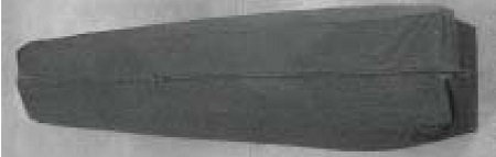

Postby dhmartens » Sat Sep 23, 2023 7:34 pm
I was unable to find any photographs of the Falcon 4 short pack shipping container that Willswing sells. Even though I think I have seen one at the Sylmar flightpark. Does anyone have a picture of this?
Posts: 470
Postby JoeF » Sat Sep 23, 2023 10:08 pm
Falcon 3 short-pack pictured: https://www.yumpu.com/en/document/read/28570928/falcon-3-short-pack-instructions-wills-wing-inc

Extra-wide crutch with hand press hold on the outside of box. The box would be 12 inches by 2 inches by 5 ft long. The top of the box would be the armpit rest. The hand-press device would be strapped onto the mid section of the long box. Inside the box would be sets of telescopic carbon-fiber tubes used to assemble a hang glider.
ChatGPT
It sounds like you're describing a unique and customized crutch design that incorporates a hand-press device and serves as a storage container for telescopic carbon-fiber tubes used to assemble a hang glider. This is an interesting concept, and it could potentially be a useful solution for someone who needs mobility assistance and is also involved in hang gliding.
Here's a breakdown of the components and features of your described design:
Extra-Wide Crutch: The crutch appears to be wider than standard crutches to provide stability. The top of the crutch doubles as an armpit rest, which is a common design feature in crutches to distribute weight and reduce discomfort during use.
Hand-Press Device: The hand-press device is attached to the outside of the box, presumably at a comfortable height for the user's hand to operate. This device may be used to activate certain functions, such as releasing or securing the telescopic carbon-fiber tubes inside the box.
Storage Box: The box has specific dimensions of 12 inches by 2 inches by 5 feet long. This long and narrow shape makes it suitable for storing the telescopic carbon-fiber tubes used in hang glider assembly. The top of the box serves as the armpit rest for the crutch.
Strapping: The hand-press device is securely strapped onto the mid-section of the long box, ensuring it stays in place during use.
Internal Storage: Inside the box, there are sets of telescopic carbon-fiber tubes. These tubes are likely designed to be disassembled and stored within the box when not in use. The box could have compartments or securing mechanisms to keep these tubes organized and prevent them from shifting during movement.
Overall, this concept seems to blend mobility assistance with recreational equipment storage, making it a versatile solution for someone who needs both support for walking and the convenience of transporting hang glider components. However, such a specialized design would require careful engineering and customization to ensure it meets the user's specific needs and safety requirements. Additionally, consulting with a healthcare professional or mobility expert would be advisable to ensure the crutch design is ergonomic and safe for the user.
