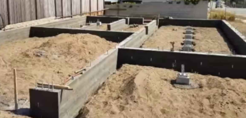

25,000 dollar foundation with an unusable crawlspace.png (164.04 KiB) Viewed 4276 times
Many “crawlspace type” houses are built on this type of excavation and foundation which requires so much extra work to dig out the ground, to frame, strip and pour concrete footers and then stem walls, then drain waterproof and insulate the perimeter, then backfill, THEN build an unusable, uninsulated, crawlspace partially above ground directly below the new house. It has no mass to it and can never be radiant heated, (55 degrees radiates), it has air vents letting in cold, Plus the crawlspace must be dehumidified or mold will grow, not to mention it can become a lost place for boxes of “stuff”, accessible by a small, hidden trap door in a closet somewhere.
All negatives for the unknowing home owner over the lifetime of the house, because they are expensive to heat and cool in the long run.

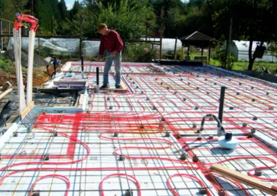

typical slab on grade HO HEAT TUBES.png (101.36 KiB) Viewed 4276 times

A home built on a "well engineered heated pad” as it's foundation, will provide radiant heat for the home for a lifetime.
4" pour with 1/2" hot water tubes
half inch heat tubes.png (272.45 KiB) Viewed 4276 times

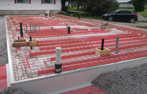

This is new from Sweden,
8" pour with 4" pvc "warm air tubes" by Legalett
35,000 dollar combination foundation and heat.png (280.43 KiB) Viewed 4276 times

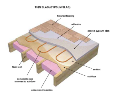

We've been doing floor heat since 1978 and it's a great way to retrofit a thin slab into an existing house or garage.
thin slab construction diagram.png (106.79 KiB) Viewed 4276 times
absolutely needs no “extra” heat above the floor, and will greatly cut utility and maintenance costs to the bone. Heat is not needed above our heads, so the beauty of a radiant floor, it heats only the things that are touching it, and not the air per say.

These Legalett systems from Sweden, have come to North America by way of Canada, where it has been used very effectively in cold climates. As soon as I saw it I fell in love with it because now an average homeowner can put one of these systems together and no hot water to mess with. Warm air is easy to make and blow through tubes, cheaply. Check them out. https://www.youtube.com/@legalettcanadainc.7983
